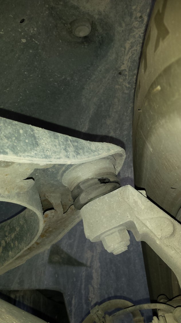

Old Sep 26, 2015 | 07:14 PM
RamGazer's Avatar
10 Year Member
Joined: Jun 2011
Posts: 437
From: Wolfforth, Tx.
Left Upper Control Arm
Right Upper Control Arm
I think this is where my noise is coming from, the left side. Is it best to replace both or just the side that is torn?
Old Sep 27, 2015 | 06:16 AM
Jeff in TD's Avatar
Posts: 3,528
From: Oregon
My theory would be if one is worn and sloppy, the others may not be far behind. If it were mine I'd replace all of them and not have to mess with it again.
