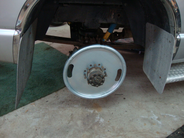

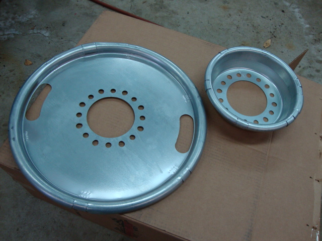

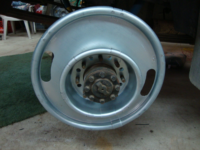

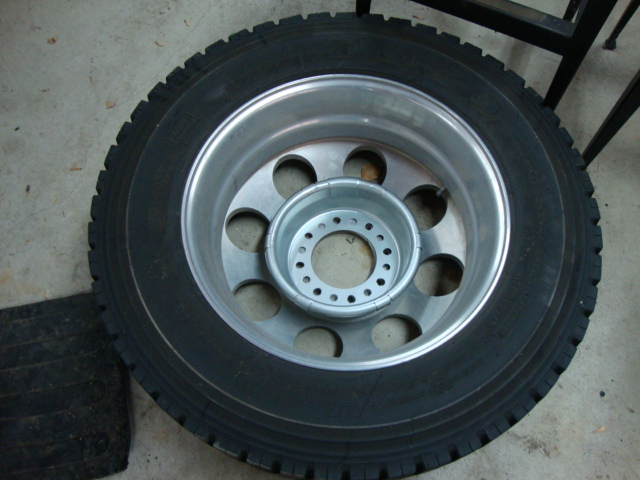

Centramatic's came in, WOW big difference from fronts which are standard for the 17" stock wheels and they say will be fine for my 19.5" to the rears for 19.5" wheels. Found great price on them from a place in OH. The front pic is just sitting in one of my rear wheels for the camera.
