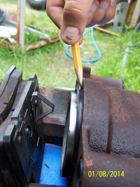

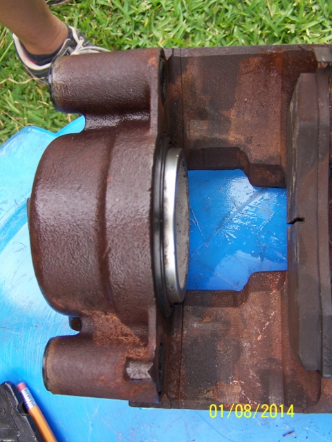

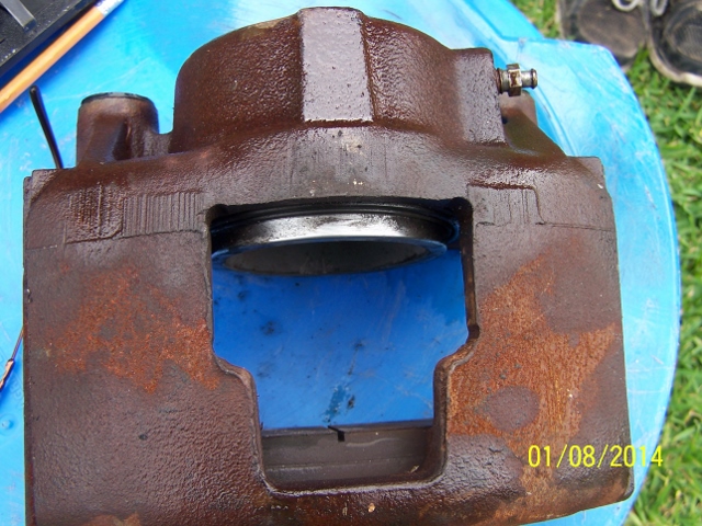

Took the right caliper back today and picked up the new one. Couldn't push the piston in on the old one even with the brake hose off of it. The rubber boot on it was coming out on one side so that may be where my problem was. My fluid doesn't flow fully clear but the truck is 15 years old so I guess a little discoloration is expected. Rotors were fine but he cleaned them up anyway at no charge. Will put it all back together tomorrow and see what happens.
Attaching a few pics of the dislodged rubber boot.
I'll report back.

Sorry to hear your having so much trouble with this but sounds like that caliper was stuck. With the bleeder open or brake hose off it should not be too difficult to retract the pistons in the caliper.
Hope that fixes it for ya.
