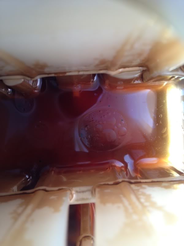

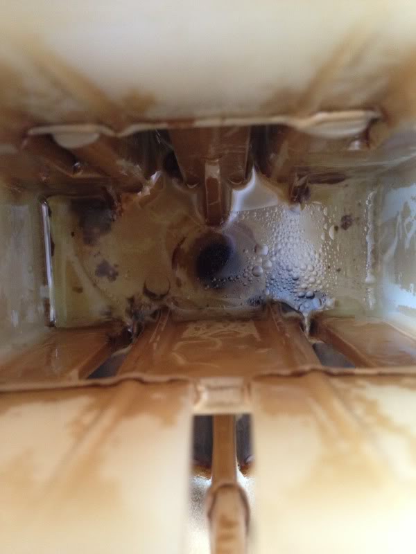

So I decided to flush the system and put in new synthetic dot 3 this morning.
A couple curious things I noticed.
1) seems to be water in the system. This COULD explain the locking brakes. If the fluid had ingested a significant amount of water, after a while of driving, the water could get hot enough to boil, then expand while trying to turn into a gas, producing pressure on the system.
I'm guessing that if water began to boil at only 1 caliper, it COULD affect the whole system, thus applying pressure to all four corners?
Is my thinking correct here? (See photos)

This is the bottom of the reservoir. You can clearly see small water droplets.

Well, 150 mile trip, mostly highway, some stop and go traffic, and zero signs of any problem. Time will tell, but a full fluid flush and change seems to have solved the problem. I'll keep my fingers crossed.

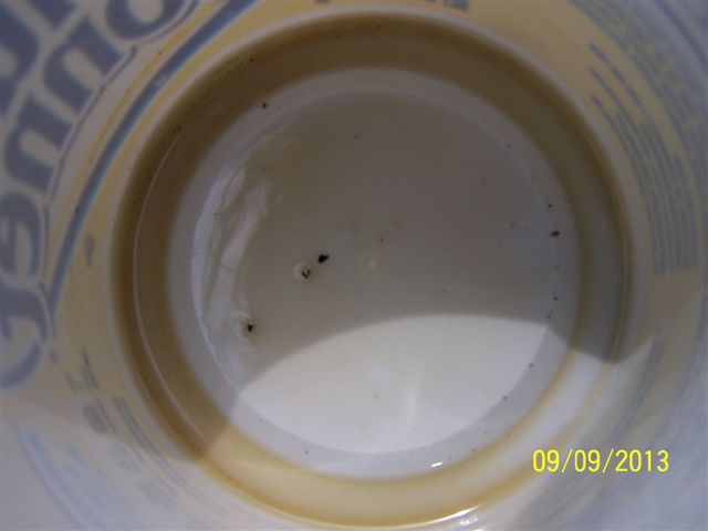

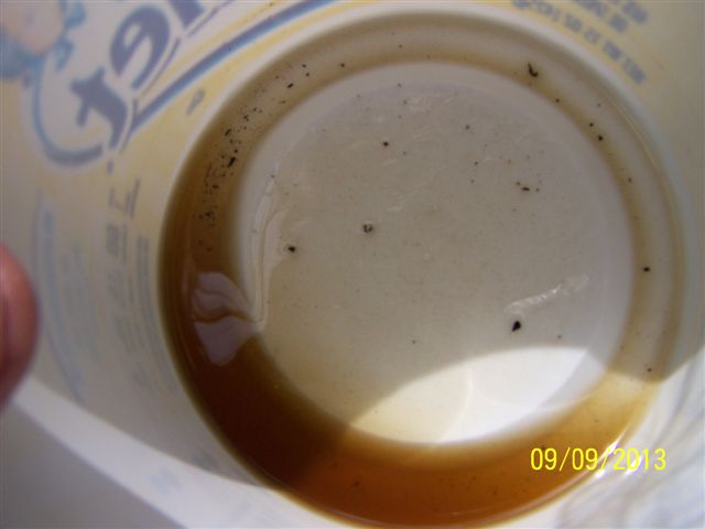

Well jmlcolorado, seems I have the same problem with the moisture. I finally got around to pulling the front calipers and hubs on the beast. Pulled the pass side bleeder plug and it has considerable rust on the tip. I pumped fluid into a jar and, DANG, it was rusty and trashy. Reckon I'll just replace the calipers, hoses and the master. $$$$ What's anybody's thoughts on blowing the rigid lines out with brake clean then air to clear the brake clean? Since my front suspension is about shot I may as well yank the whole front end down while I'm this far into it. I promised myself way back that I'd never ever rebuild another front end this late in life. Oh well. promises are made to break. Dodge and Cummins probably have big meetings and sit around laughing their butts off saying things like "Can you believe all these fools we have addicted to and in love with these old trucks?"

I don't see the water drops like I did mine, but there are some nasty particles in there. Replacement front calipers are probably the best idea!
