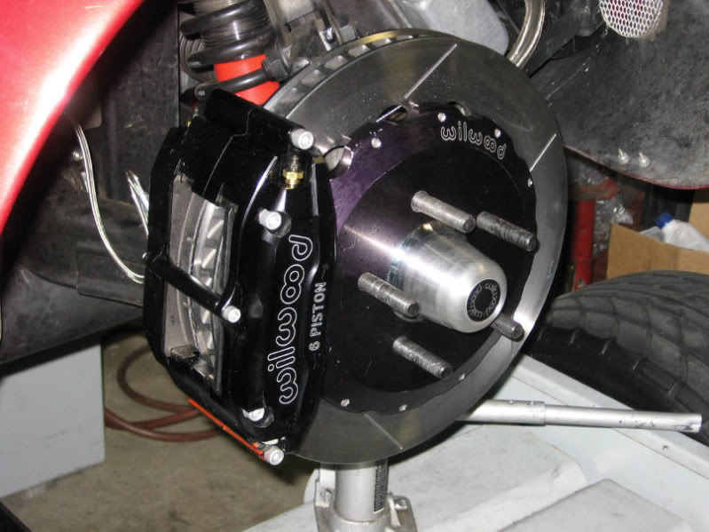

No. The slots are used on during racing. In hard use (racing) the high heat generated can glaze even a good race pad. The slots will shave off that glazed surface and get you back to a fresh surface.
The trade off is lots of dust and shortened pad life.
This is a picture of the brakes on the front of my race car. Notice there are no holes or dimples. Only the slots.

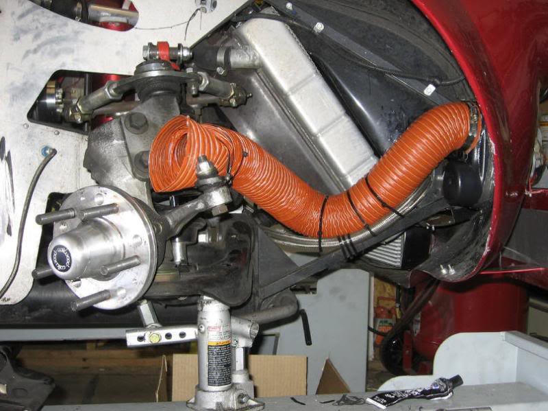

For additional cooling, I added these ducts. And this made a huge difference. Especially towards the end of the race. If your brakes are overheating, this is what you should do. Inexpensive, effective, easy to do, and lasts forever.
