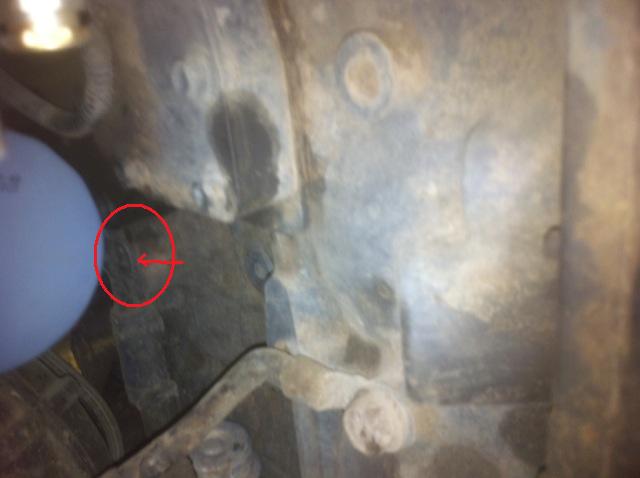

Everywhere I have read on here states that Cummins installs the block heater, that only the cord is optional. On my last Dodge this was the case, on this truck, 2004 I ordered a cable from genos only to crawl under and find that there was no heater. My question is this, when I order the engine heater and pull the plug out will I lose all coolant and what are the torque specs. Does the heater need thread sealer? How common is this not to have a heater installed?

Ok, from the top:
1. Yes you will lose some coolant but, if you're quick, it won't be very much.
2. Yes, you need either thread sealant or teflon tape.
3. Torque is 55 ft lbs/75Nm
4. According to the manual, it was optional!

I am looking at the correct plug to remove arent I, seems to be removed with a 3/8 rachet.

That's a first for me...
There are a few pics in this thread that shows the location a little better.
https://www.dieseltruckresource.com/...l-t223768.html

To the OP. Look at madhat's post. The pic you took is not the right plug. The cord can be bought from Cummins, the dealer, Geno's or Napa.

He's talking about missing the actual element...
Old Jan 22, 2011 | 09:25 PM
hmclaxt's Avatar
Joined: Jun 2005
Posts: 42
Correct I have the cord, arrived today, I am missing the element, theres a plug screwed into the block that removes with a 3/8 rachet. What does cummins get for the element, Genos is $28.95
