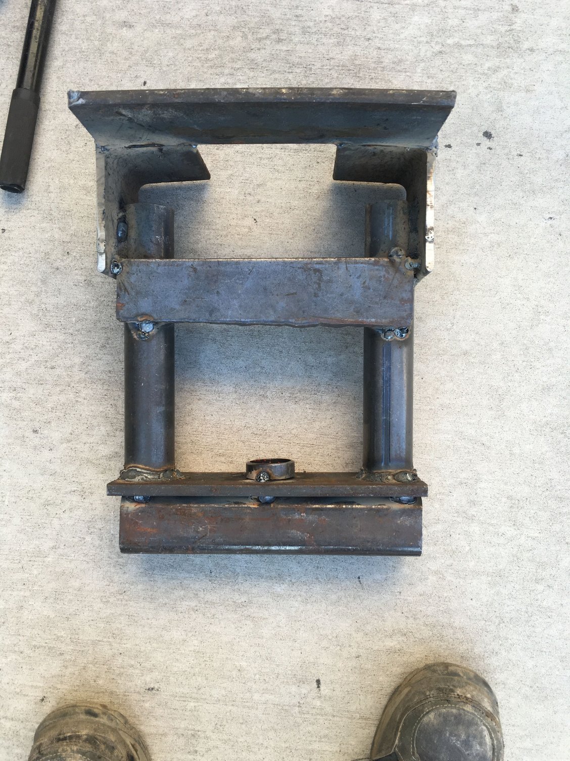

Been banging on my passenger side hub bearing for a week. Tried every trick in the book. So tomorrow this thing is coming off with my new parts breaker. 😂

Nice puller. Suggestion; turn the jack around or use a heavy steel base plate. The reason I am saying this is that maybe a concentrated load on that area of the jack could crack the case. The heavy steel plate will help to spread the load.

Thanks for the suggestions. I have the axle nut flush with axle and a small 1/4 plate between jack and axle.
After at least 2-3 tons of pressure and 8lb sledge banging for an hour I give up. Hub will not budge. Maybe porta power?

Thanks Bob. My buddy just brought over his service truck. I put the heat to it with a rose bud. So much pressure on my press that it broke. Going to chisel it off. Made a sawzall cut on top. Will attack it tomorrow afternoon.
