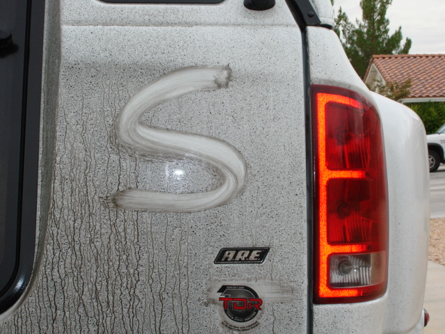

Dan_K Did the back of your truck look like this?

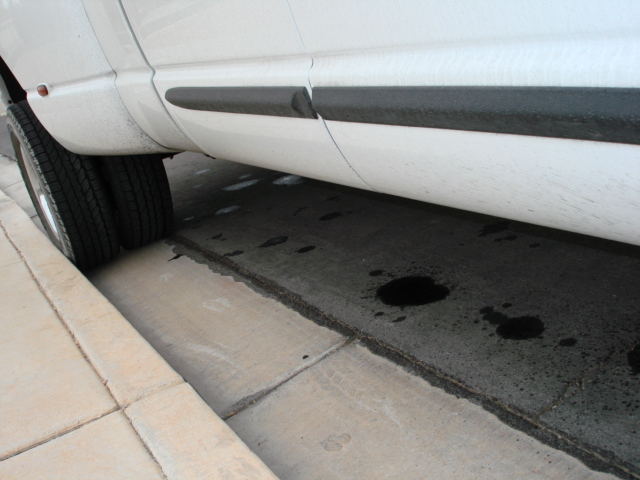

And the street under your truck look like this? This was a sad day.
Attached Thumbnails Is this a bad injector-dsc00053.jpg   Is this a bad injector-dsc00052.jpg

Dude that look has if your oil filter might have loosened up a tad. I had that problem once and was freaking out until I looked at the top of my filter and found that is were the oil was coming from. Also a buddy of mine screwed up his turbo real bad and was leaking from the compressor clamp that holds it to the turbo housing and was also just blowing oil right out of his tailpipe.

Jay,
Thats what she looked like, except I was off to the side of the hwy and 1/4 mile from losing my cell phone signal. My enclosed snowmobile trailer was covered in oil.

Dude, you lost an injector(s) if it looked like that. Typically it happens on the 04.5 600 trucks because they were the first model with the 3rd injection event to help with emissions.
An injector will stick open causing cylinder wash down and ultimately filling your crankcase with fuel. Once it gets so full it dumps out the breather and coats the entire underbody with "foil". <---- That's the word we created for the fuel/oil mixture it creates. In fact, I'm wearing my "foil" t-shirt right now. It was the one I was wearing the night this problem happened.
Oh, do not..... I repeat DO NOT continue to drive with this problem. Think for 2 seconds..... what else uses the engine oil to lubricate and cool? Yep, your turbo. My friends truck only went 20 miles with a stuck injector before we figured out what it was. As soon as the oil pressure took a dive we immediately shut it off, called for service, and had a flatbed take it to the dealer.
