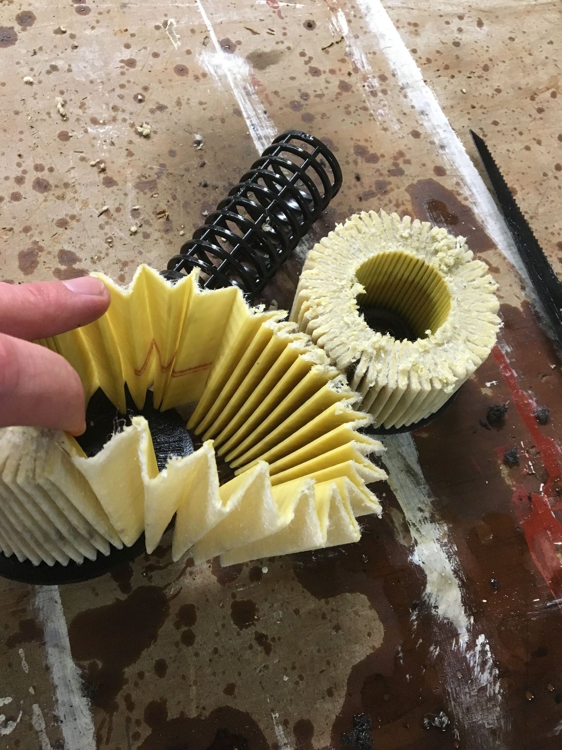

Before you go all crazy, cut a filter open and let us know what it looks like inside.
Not all Biodiesel is made to ASTM specs....... you could have gotten that bad batch that slips thru.

Thanks for the info guys. Work is getting in the way of me getting to this right now, but I will sometime soon. I'll check that wiring, and I'll cut open the last filter, I never thought of that. From what I could see on the inside it looked really clean. I know looks can be deceiving so I didn't think a lot of it. I don't know what to expect to find when I cut it open but it sure can't hurt to see in there.

Well, I cut open the filter, and while I'm the first to admit I'm no filter expert, and I don't really know what I'm looking at, it sure seems clean to me. It's hard for me to imagine this was causing any problems for me.

That filter is fine............. something is wrong with the LP, either fuse, wires or the intank pump has died.
