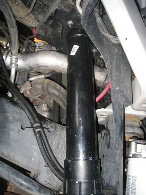

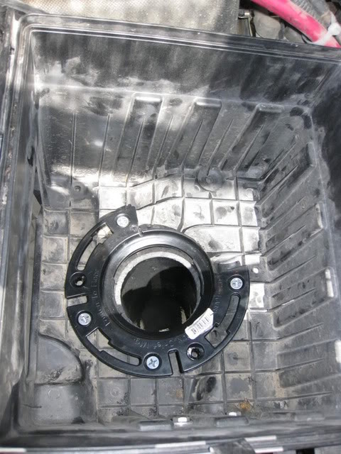

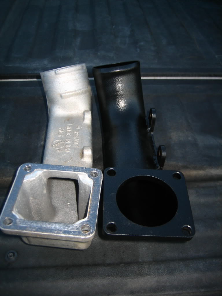

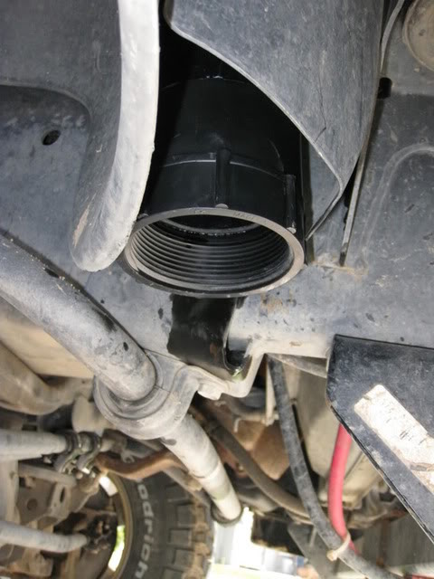

The stock intake system is good for at least 450rwhp, and aftermaket CAI's will show no improvement in this realm. I have seen this on a dyno with my truck and a truck with a AFE Stage II, otherwise the same truck and tuning.
I have made 3 mods to my intake setup, and all have shown an improvment in IAT's, restriction, throttle response, and low end smoke. Some helped with all of those.
1) Airaid MIT, removes the baffles in the stock torque tube. Smooths the airflow and flows better. linky
2) GDP Intake horn. Removes the large restriction in the stock horn. Improvements were noticed. linky
3) Home Depot CAI. This keeps me from drawing the filter minder down as easily, especially after the cam install since I now move a LOT more air. linky
The grand total for those 3 mods is less than $350 and worth it. You will get much better performance than any CAI on the market, for less money. The mods really shine in the 1400-2400 rpm range, and help the turbo spool faster. I dropped about 100 rpms to get to 30psi of boost. I am down to 1950rpms for 30psi.
As for the grid heater I know a local guy who laid down 908 on a stock IC and grid heater at 4K feet elevation, so they aren't overly restrictive, but I would guess that they are the biggest restriction at low boost/flow.

The links I put in my post have pics, but here are a couple for this thread.
