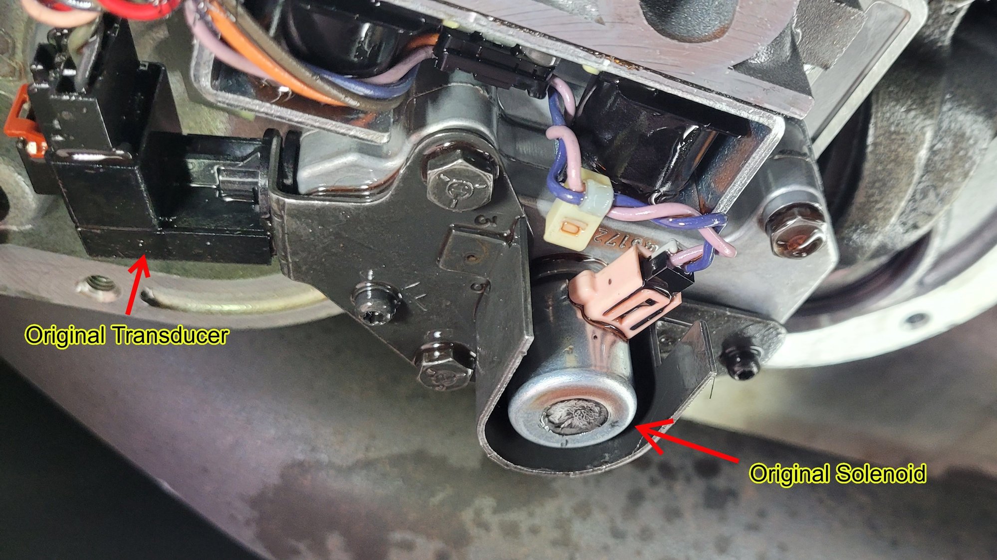

This is a photo of the original Transducer and Solenoid before upgrade

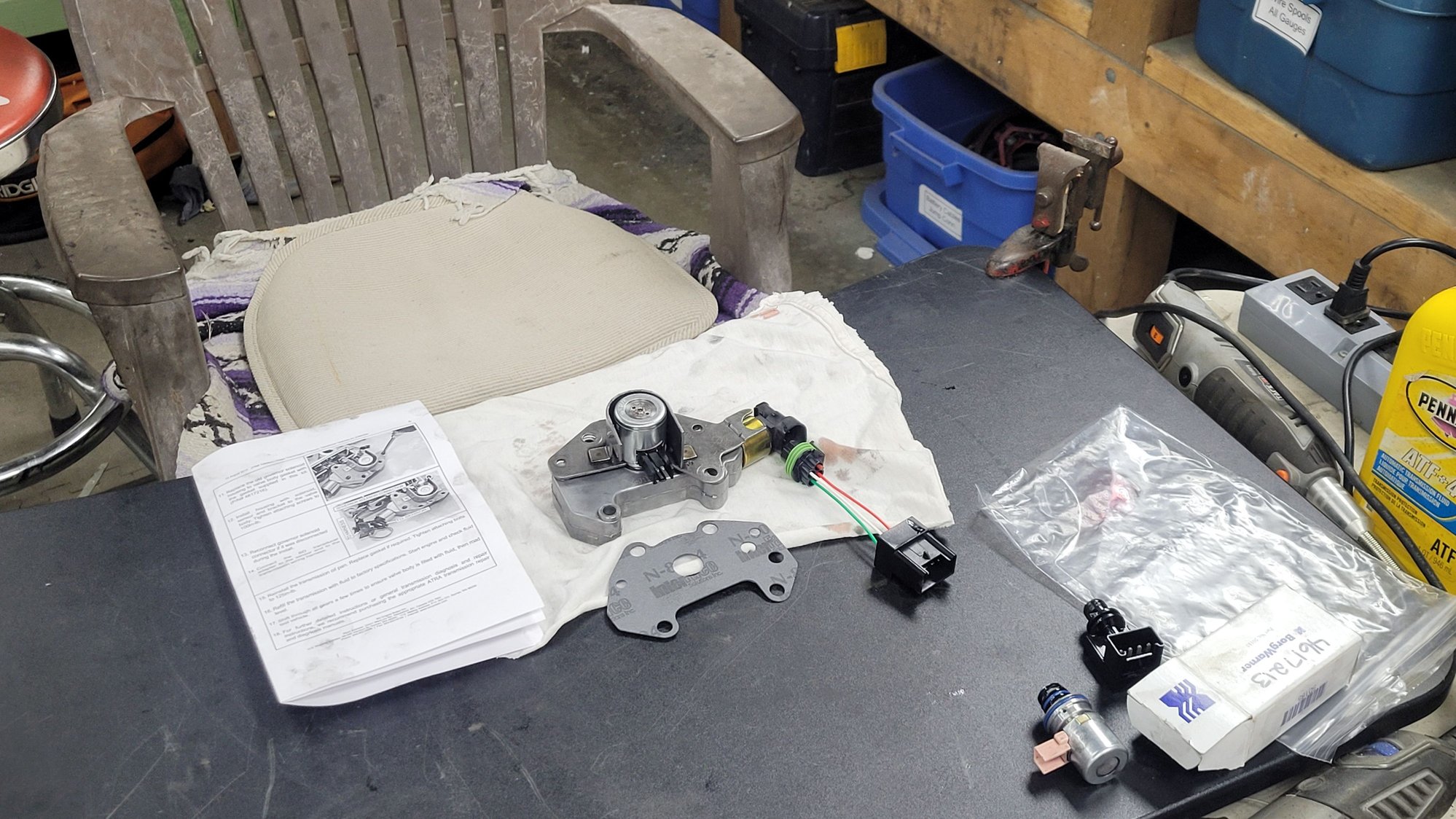

Transducer Kit
Transducer Kit
New Transducer and Solenoid installed in valve body ready to be installed.
