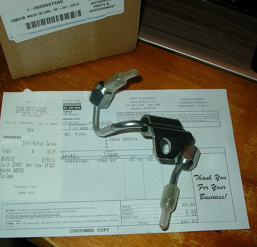

Just picked up the new #4 line.
PN: 5086874AC
$60.85 +tax
12mth warranty w/receipt

Old Aug 23, 2013 | 11:50 PM
.boB's Avatar
Posts: 1,409
From: Colorado Springs, CO
Yup, that's exactly the one I used. It really is a 10 minute job. Wish I had done it in my drive way.

Geno's offers the #4 line for $26.00. They list the pn# as 5289447?
Old Aug 24, 2013 | 09:32 AM
Shorts's Avatar
Posts: 1,688
From: Texas
Perhaps part numbers 5086874AC is MOPAR and 5289447 is CUMMINS?
The photo Geno's shows is of the new part. And a quick google seems to confirm that part number is correct. Geno's has a MUCH better price than the dealer (as if that is a surprise)
Oh well, I'll keep my overpriced line and get it installed as I'm on a tight timeline. But the rest of yous out there, looks like buying from Geno's would be the way to go to save a little money.

The important thing is you've got the new part in. I need to swap mine out and keep the old one for a spare.
Old Aug 24, 2013 | 12:15 PM
ChrisJohnson's Avatar
Posts: 275
From: Corpus Christi TX
Thank you Shorts for the pic. My spare # 4 line is the old style. I'll be ordering the newer style shortly. As I said before, I'll keep my older style spare as a spare for the spare!

Bob, at the dealership, gave me these instructions for installing the new part:
- Place the new line in position
- thread the flare nuts on a few turns by hand.
- Install the bracket bolt, and tighten with a 10mm socket
- Using a 3/4" open end or flare wrench, tighten the flare nuts to 27 ft/lbs.
-- that's kinda tight, but not TTYF
It took me exactly 10 minutes to R&R the line.
Going outside to replace the line now. Do I use the existing bolt that is on the truck now? The new line did not come with any hardware. I haven't popped the hood yet so forgive the elementary inquiry
Edit. Just looked at it. I use the bolt that hold the stock bracket to the head cover.
