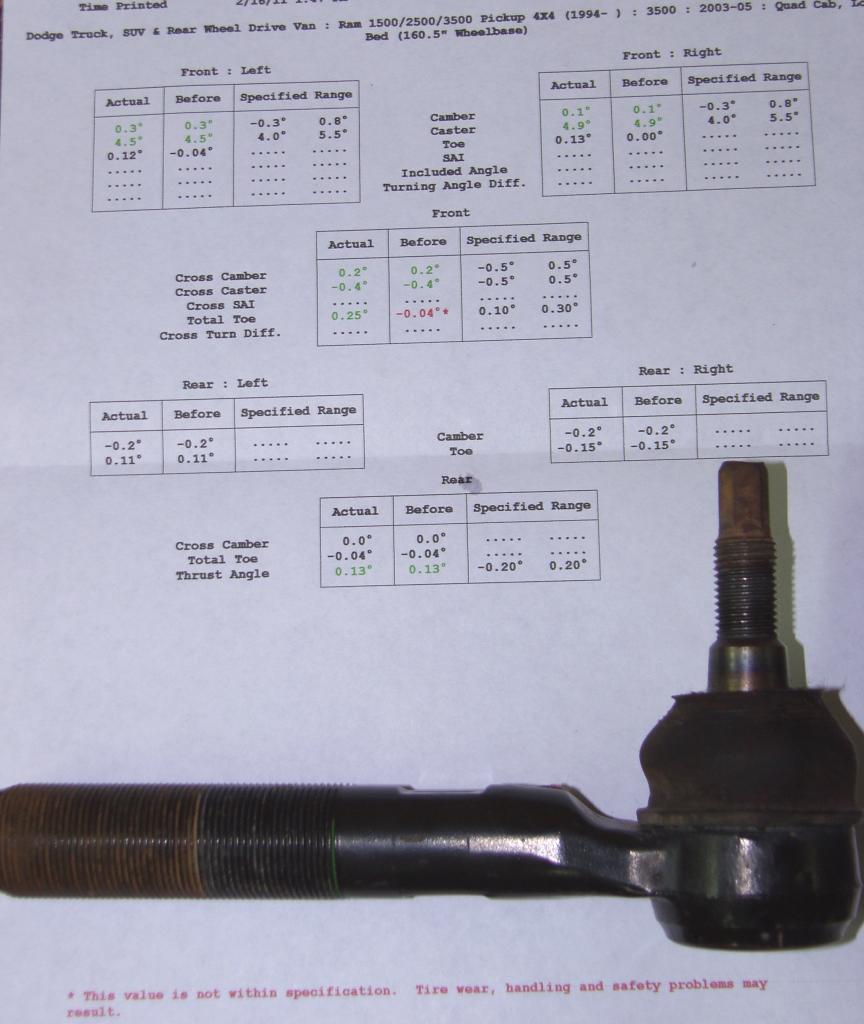

Productive day under the truck. Found the clunk. Defeated the death wobble.
Dented SS was AOK, just looks bad. Shocks were fine as were Sway bar links. Tie Rod ends at the steering knuckles were fine. Track bar, pitman arm AOK.
The death wobble culprit was a worn TRE at the pitman arm and a down right lie by the dealership that's finally, finally, going out of business.
They did my ball joints (OEM parts - yes I know they're junk, but this was covered under warranty and I'm not going under the truck in -20F weather). Let them knock 70k miles worth of rust off the components. Then in the spring I'll only have 2k worth to remove when the Dynatracs go in.
Anyway, they were supposed to and claimed to have put it on the alignment rack afterward. Did not. Check the toe. Could not induce the wobble and the steering is much improved.
The clunk is the driver side sway bar bushing, which is worn and split. Shove up on the swaybar and it hits the frame - clunk!

I will take a picture and post so you can see what my problem was and the fix. I mis-spoke - I meant steering stabilizer above - not sway bar. Basically, rather than replace just the outer tie rod, I had a whole new kit put in - I didnt want to just replace outer rod and have it happen again - that was pretty scary to have tie rod go out while driving.
