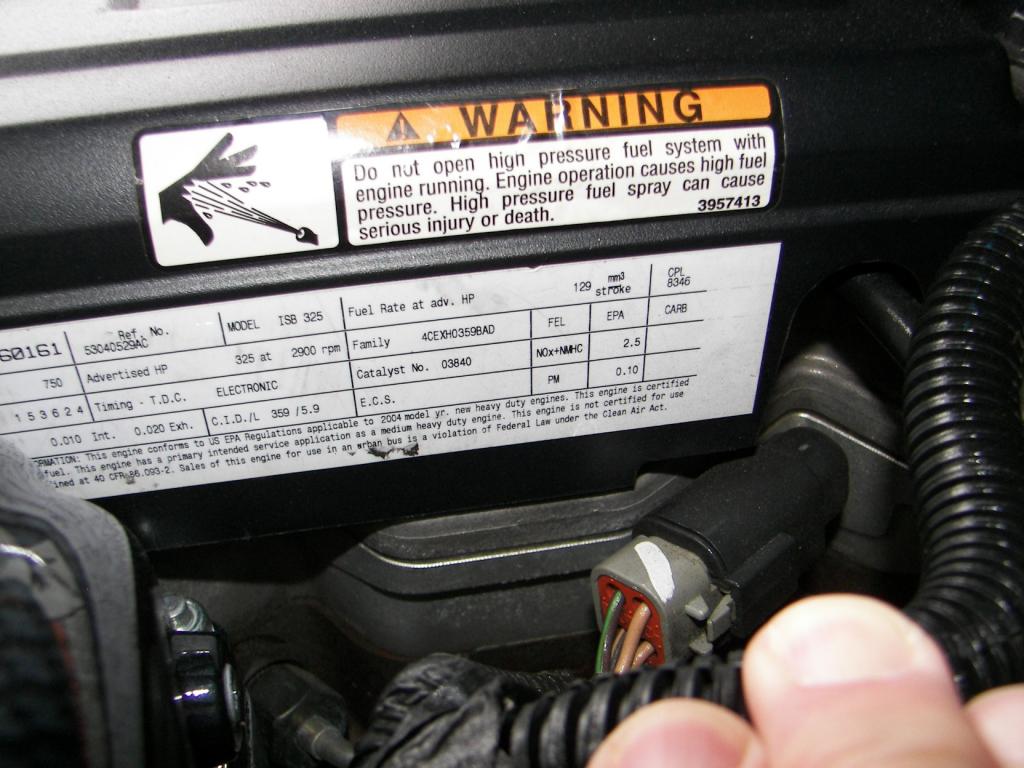

I have a 2007 with the 5.9L.
The 5.9L highest rating was 325 hp and 610 ft lbs from 2005 to early 2007. The 6.7L was the one that got the 350 hp.
From the TDR buyers guide. ---->
Engine Ratings:
For early ‘07 models, 325 HP and 610 ft-lbs for consumer
pickup models 2500 and 3500. This is a carry-over of the
Cummins 5.9 liter engine.
The 2007.5 consumer pickup models 2500 and 3500 received
the Cummins
6.7 liter engine
rated at 350 HP and
650 ft-lbs torque with the automatic transmission, 350HP
and 610 ft-lbs torque with the manual transmission.

Here is the 2003 complete break down.
2003 S.O. Federal Emissions: 250HP/460lb.ft. Available with NV4500 or 47RE
2003 S.O. Calif. Emissions: 235HP/460lb.ft. Available with NV4500 or 47RE - Cat equipped.
2003 H.O. Federal Emissions: 305HP/555lb.ft. Only available with NV5600 and 47RE until January 2003 when 47RE was replaced by the 48RE automatic transmission. The HO also has piston cooling jets.

The 325 hp was introduced on the 04.5 model year. If ordering engine parts directly from Cummins,you would need to provide the engine information located on the drivers side of the black plastic valve cover. There are no major parts differences between the 03 model year HO and SO motors.

Look at the 8th digit of the VIN #. If it's a "6" it's an SO. If it's a "C" then it's an HO for the model year. 305 as you noted would be HO.
