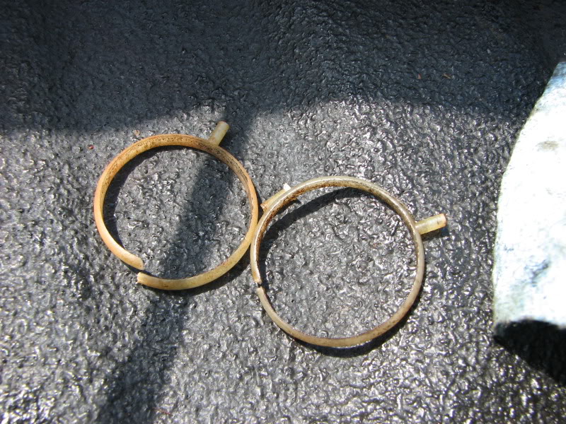

This is what the injected ring looks like on the front driveshaft.
You do not always need to use heat. I used a typical u-joint c-clamp, and a ratchet with a cheater bar. It took a little bit of force, but the plastic eventually sheared.

You do not re-do the plastic injected rings. They are a one time only, factory install. The replacement u-joints that are installed, even the factory ones, use a standard c-clip that is on the inside of the yoke.
