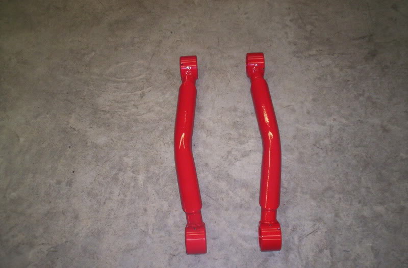

Here is a picture of the kind of control arm you'll need if you don't want the tire rubbing the control arm .
