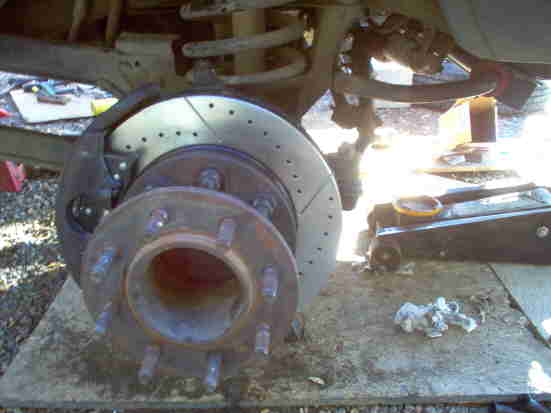

I just replaced mine with NAPA drilled/slotted rotors and their best pads. I considered Power Slot drilled/slotted/cyrogenic and Hawk pads both from Summit. I chose the NAPA ones because they were made in USA not offshore and the drilled holes were not as many as the others. I think too many holes would weaken the rotors. The rotors were about $140 apiece and the pads about $70 for the set. I got the best they had.

It wasn't easy and a first time for me a few months ago. I have the unitized hubs and most guys have trouble unbolting the hub from the knuckle. Just about the first thing needed is removing the big axle nut (I think its 1 7/8 inch...not sure but it was big) and mine would not budge even with a 4 foot breaker bar...and most don't have this problem but I did. Finally I heated it with a MAPP gas torch and then it broke free. Too much heat will fry the hub bearings. The studs on rotor were easy. Just pound out and use the wheel nut to pull back in on new rotor.
The 4 bolts holding hub to knuckle were hard to get off but they finally popped. Watch out for the axle shaft falling and messing up the seal. I still have some pics if you want me to share with you.
