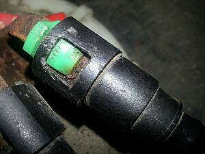

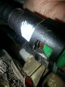

I took some pictures with the macro setting of my phone to see what I was working with, looks like rust and dirt are making my life difficult. I'm getting desperate, any more suggestions are absolutely welcomed

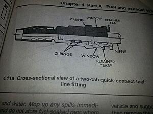

Last thing we need is confusion, so I'll post the pics. Looks to me like either a normal diconnect tool should work (if there were enough of a straight line prior to the casing) or pushing the retainer ears (as labeled) inward would release:
From a Haynes manual I forgot I had (but doesn't actually tell you the proper way to disconnect):
Top-down:
Bottom-up:

The dirt and crudd is the problem spray wd40 and blow it all off with shop air watch your eyes where eye protection. We don't see that much corrosion out here on the west coast, never rains here.

Looks like your fuel lines out the fuel sending unit are getting pretty rusty.
I have had a set rust out on me, leaving me stranded on the highway, with a loaded trailer in tow.
It was a long cold night sleeping in the truck with the dog…
I would expect to swap that sender out in the near future.
The WD-40 and compressed air should remove some of the crud and give you some room to compress those "ears" into and remove the line.
