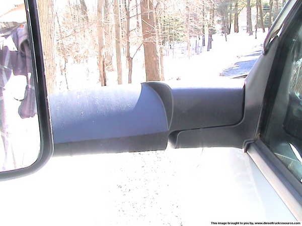

I wouldn't say they look horrible, I did this and the gap is not that noticable. There is however more work to make the conversion for the newer powered flip mirrors.
Old Jun 4, 2007 | 03:40 PM
01RAMer's Avatar
Posts: 328
From: Gardners, PA
Here's a view of my mirror:

Where were you when I was asking about mirrors??
Old Jun 4, 2007 | 08:07 PM
badme's Avatar
Posts: 844
From: Claremont, NH
I guess you are right, they look just like dodge made them. I am just used to better fit and finish than what dodge gives us. I sure do wish they would put a cummins diesel in a gm truck, I would be the first one in line for one.
Old Jun 6, 2007 | 12:02 PM
01RAMer's Avatar
Posts: 328
From: Gardners, PA
They don't fit exactly but there are close enough to look ok. The front is more rounded then the base, compared to the original, but again, I wouldn't say they look bad.
