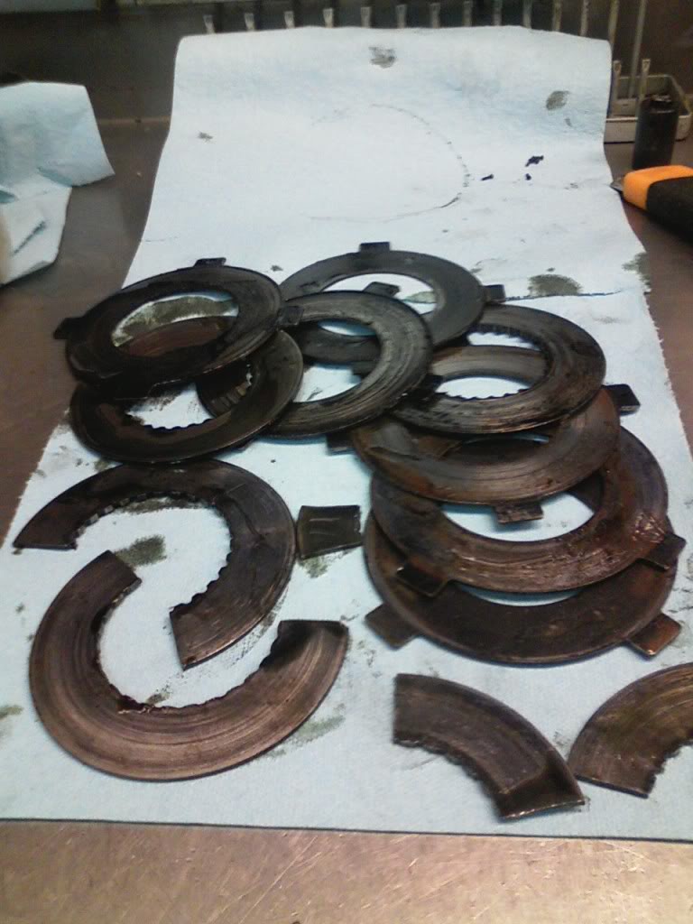

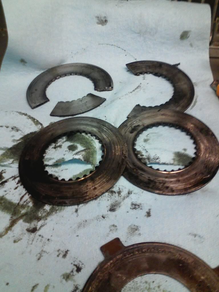

add some more slip additive first, its like 6=7 dollars, if you drop the cover inspect every thing before throwing expensive oil in there. when mine had no additive it was an aweful shudder when cornering or backing up
heres what my limited slip looked like, it made no hopping/bucking, just acted like a one wheel peeler
cost about 100 to replace the disc and steels

I agree with SIXSLUG. If its as bad as you claim then there's probably an issue. I dont care if you never use friction modifier, the OEM limited slip should never be so tight that you have wheel hope. Chatter when the differential gets warm.....yes.....but grabbing and hoping tires.....no. Especially since the hot weather is over. The Mag Hytec has a drain plug so drain the lube, save it, inspect the carrier for issues, then reuse the lube if all checks out. Dont try to cover something up by adding more stuff.
