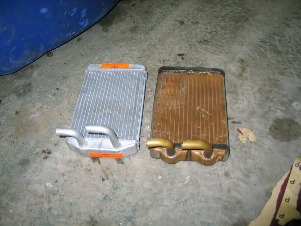

As mentioned here before the core can be replaced much quicker by cutting the tubes and then splicing them back together with heater hose and clamps. This eliminates removing the heater box, draining the coolant, or discharging the AC system.
Didn't even have to open the hood.
I was quite surprised how quick the dash came out, bunch of screws on top near the windshield(Cordless drill with extension made quick work of them), 2 big bolts on each side of the dash just underneath and then some screw in the center on the floor and drop the steering column, 3/8s impact for that. Take the glove box right out.
Dash held back with strap to upper door latch
Cut off with air powered cut off wheel. I spent some cleaning up the ends of the cut tube with a round file and coarse emery cloth.
I lost about a cup of coolant (which was easily soaked up with some paper towel) plus what was in the core.
I tightened the hose clamps with a 1/4 ratchet and socket to make sure they were good and tight.

PS-I was the one that cut the heater core pipes and posted the procedure on here originaly, about a month or so ago, only thing I didnt post any pics,cLAYH did a fantastic job of documenting the procedure with pics,Thanks cLAYH, just a side note,if them clamps ever leak,which I doubt, just slip the glove box out,reach in with a nut driver and tighten them up, providing you have the hose clamps posistioned corectly and cLAYH does and so is mine.

Re-swivel pipes on Napas heater core, no doubt they are good but remember that those swivel ends have some sort of a seal, probably an o-ring, so as far as leaks go, I have just as much faith in a clamped heater hose as a swivel with an o-ring, in fact even more so, the crimping that holds those swivel ends in leaves a lot to be desired,pretty mickey mouse looking, the core I installed had the swivel ends and I had every intention on installing it as per instructions someone posted on here ,but once I got the dash back,i could see no reason whatsoever to slide the whole unit back and fiddle around trying to manouver those pipes thru the firewall,furthermore the original core pipes had to be cut to get it out anyway, now, if I would have known that I was going to cut the new core pipes and conect them like I did,I would have bought a core like cLAYH did,no swivewls, not needed.
Another thing,(hindsight of course) and I stated this in my original writeup,I would have removed all the original pipes that come thru the firewall and put new long enough hoses thru the firewall and connect directly to the new core with the cut pipes,this would have eliminated one extra clamp on each hose and it would make it very easy to replace the core again in the event of a leaky core or whatever, simple procedure-once dash is lifted,loosen 2 clamps,slide hoses off,lift out core,cut pipes on new core,drop in core,slip hoses on,tighten 2 clamps,done deal, lose a 1/4 cup of antifreeze which you can soak up with a rag, no mess,no fuss,could do the whole deal in a hour or less even.
