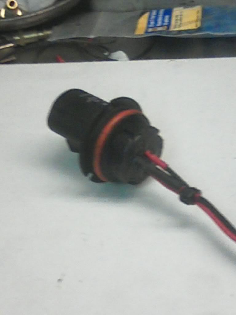

Here's a couple of shots of one of the lights straight out of the box:
