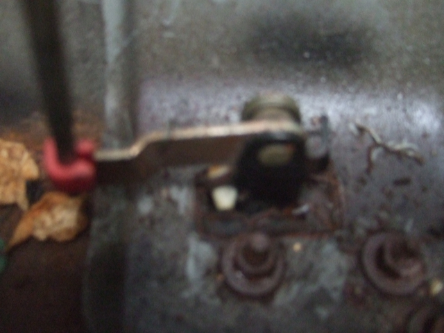

Sorry for the blur, this is the quad cab lower latch, you may need to brake off the nuts, and the little arm, if pulling on the arm does not release the latch and open the door... Don't forget to pull the top latch as well. The rod comes off with the red plastic tab.

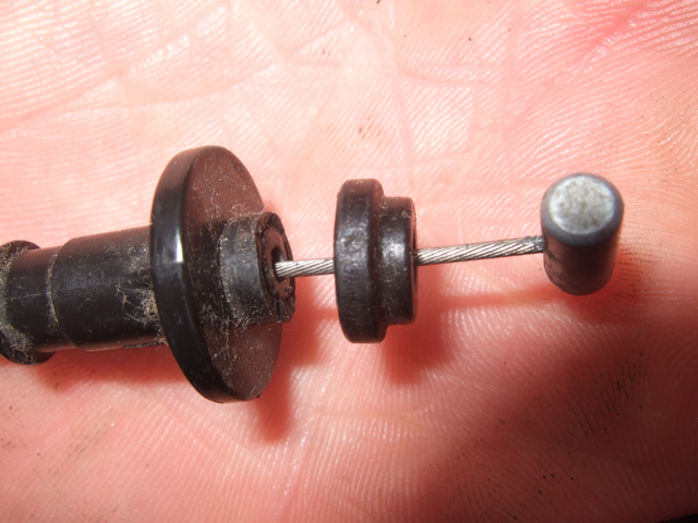

This is the quad cab outer door handle mechanism from inside the door, the upper rod is still attached, the lower has been removed, and you can see a curved piece that holds the cable that comes from the inside door handle. That keyhole looking hole in the bracket is supposed to hole the cable in line with the mechanism.

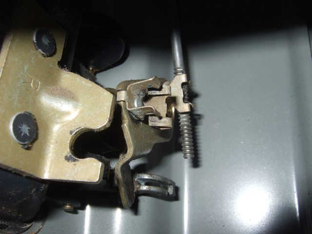

This is what happens to the cable, the little plastic piece floating in the middle is supposed to be attached to the end of the plastic cable cover. It hold the cable in line with the latch. You may be able to epoxy this back in place,, I will leave it out, and just use the outer handle.

that little peice you show in your picture is the one i epoxied. its held for 2 years now. i ddi just disconnect it and only open from the outside, but after awhile it bugged me that it didnt work right
