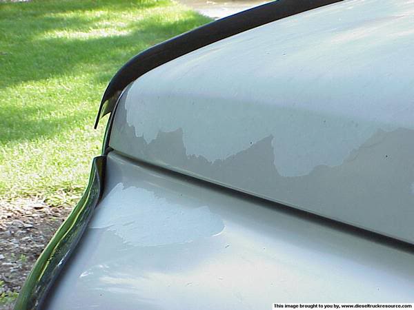

Problem happened when the EPA required low VOC (fumes) paint.
The big three all used the new primer without long term testing.
Ford and GM quit using the inferior primer right away and repainted the effected vehicles for free right away.
Chrysler kept using the defective paint for several more years and made people jump though hoops to get new paint.
I took Chrysler to small claims court, they didn't show up and I was awarded $5000 to have the truck striped down to bare metal and repainted.
Sort of doubt if you could sue them this far out.
