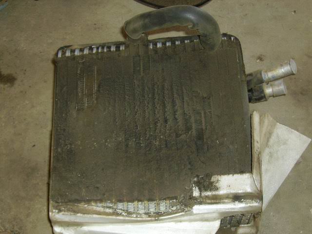

no need to drill a hole, just pull the fan out (3 bolts) and you can look up in there, its a tight fit, but the evap core is visable, hopefully it does not look like mine did, if it does a bottle of electrical contact/brake clean will wash it off, easily, just get a low fume type as it stinks the high heavens
mine looked like this! I had virtually no air flow thru the vents

ok i just washed out my heater core and WOW what a world of a difference. i had some guy flush my radatior and heater core back in april, but guess he didnt do a good job! (there goes $100) but find out what direction the water flows (hose coming from engine block is supply, and the other hose is the return). undo both hoses, hook your garden hose up to the return, and just let the water flow... i would turn it on, then stop. then turn it on again, did this several times. do that to both sides, if your still having problems with it you can add some chemicals and let em sit, but mine wasnt that bad!
