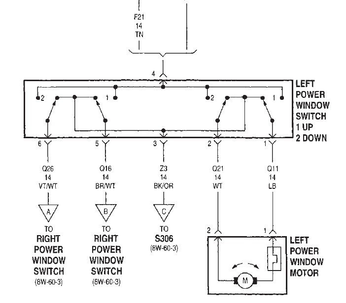

I need to bypass the switch to see if it is the problem. Then I'll check the rollers.

From my 97 SM, but should be the same.
Which two wires make the drivers window go up?-97-drivers-side-power-window-switch-check.jpg
Which two wires make the drivers window go up?-97-drivers-window-circuit.jpg
