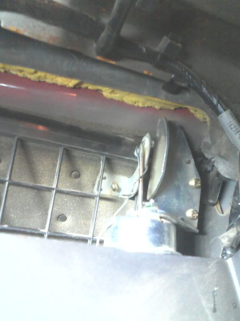

remove the glove box, reach in and instal a piece of broom handle between the door actuator and the cab of the truck, this holds the door open so that warm air can be mixed with the cold outside air, thus more warm air makes it to the cab
you can lock wire it as well, Thats what I did the first time
