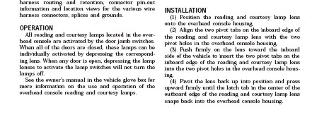

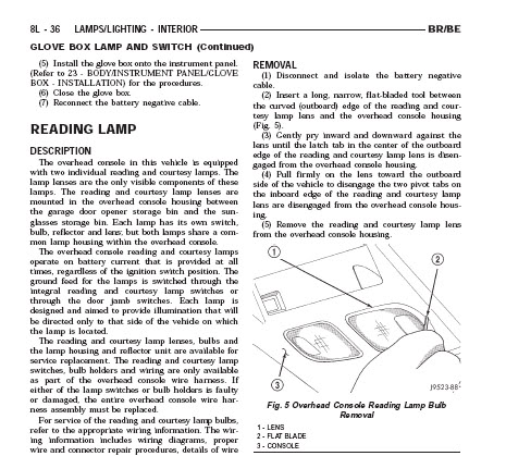

The overhead console lights no longer work. Not only do they not light up with the rear cab light, they don't even click when you push them. I'm guessing the switches popped out and that I need to epoxy them back in place. Is this commonplace?

The overhead lights can usually be repaired as the tabs are almost always what break. Do check the bulbs though.

My DS map light is broken too, won't click, I did a little quick searching on it when it first happened and it seems to be somewhat common, not sure exactly what causes it though as it just hasn't bugged me enough to replace it yet.

we are just trying to help. many times it is the simplest thing but not always. my map lights come on with the dome light, either the switch or the door open, try taking them out and see if you are getting power to them while the other dome lights are on.
Here is a replacement for the overhead map light switches to bookmark, in case they are bad.

Interior lights are disabled in that position.
