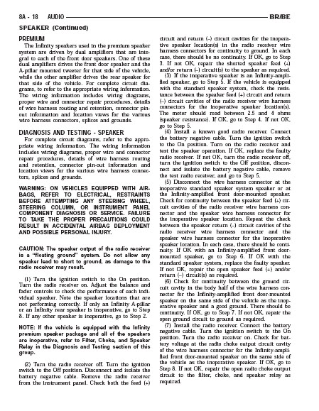

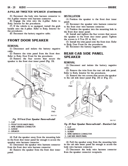

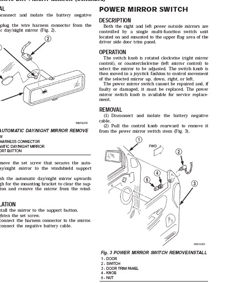

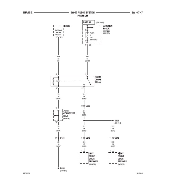

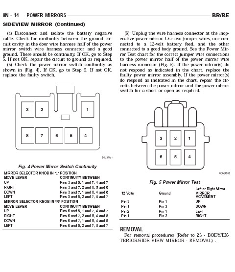

And thanks for the scans from the TSM. They're a lot more detailed than what I've seen in Mitchell On Demand and Alldata. Unfortunately I don't have access to Chrysler's online system anymore...

The rears were 5.25" 2-ways. I replaced them with a set of discontinued Pioneers from Best Buy that were on clearance - $19.99 for what were previously $60 speakers.
I've been afraid of pulling the door panel off on account of the pain in the rear I had with the rears, even after going to Harbor Freight and buying a door/trim removal kit.
If you enjoyed removing the rear door panel, you'll love the fronts. Dodge so screwed up on that, as well as most of the interior assemblies, that overhead light your having trouble with, mines busted to, it's the plastic pivot point that gives out, should be a better design for all the force it takes, I just pull mind down re-snap it into place and move on. I've been in auto trimming for 10 years, these door panels (and others) are not really designed to be removed w/out causeing damage ("thanks Dodge"). Oh first time I thought my overhead light was non functional, I forgot to check my bulbs, so I guess there are few idiots trying to help you out.
