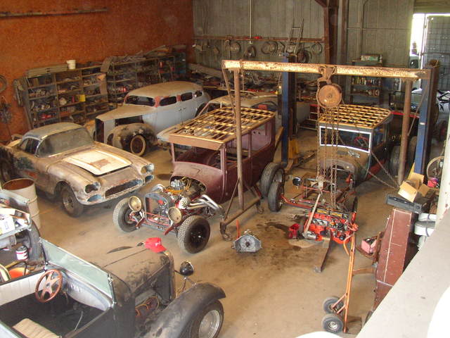

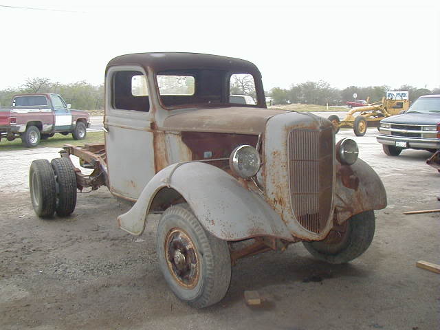

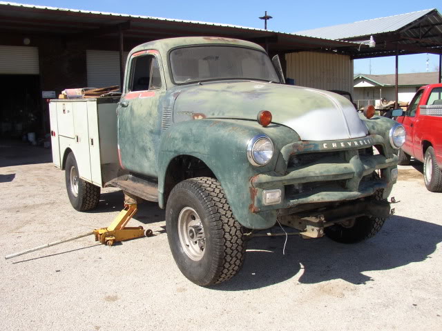

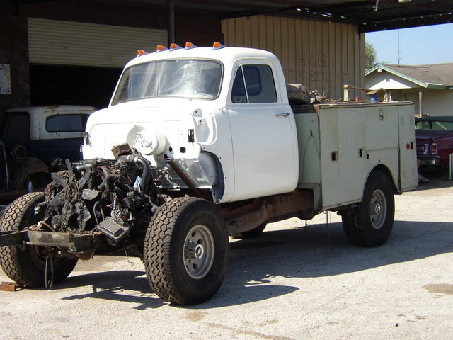

Hello guys, have been lurking around this site for a while and getting a lot of info. Time flys because I saw on my profile I joined in Feb. 06. Anyway, need some advice. Don't know a lot about cummins, but I need to learn. I have a hotrod shop. I have a '54 chevy 6600 sitting on a '92 dodge 3/4 cummins, a '36 ford 1 1/2 I'm about to put a 4BT into it and I just bought a 2002 Dodge 3500 flatbed.
