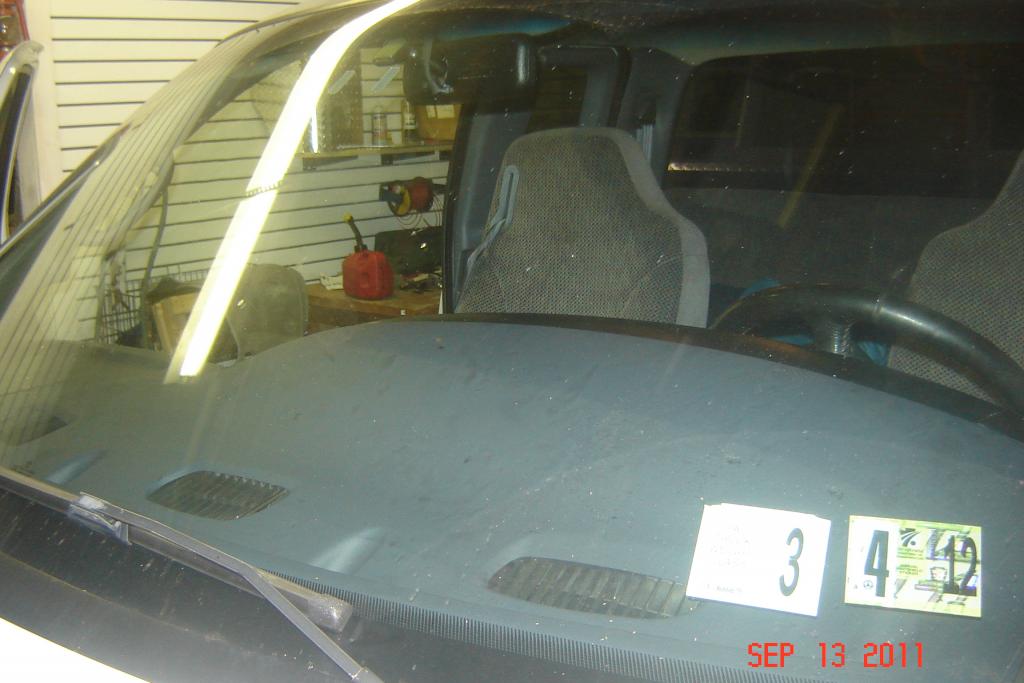

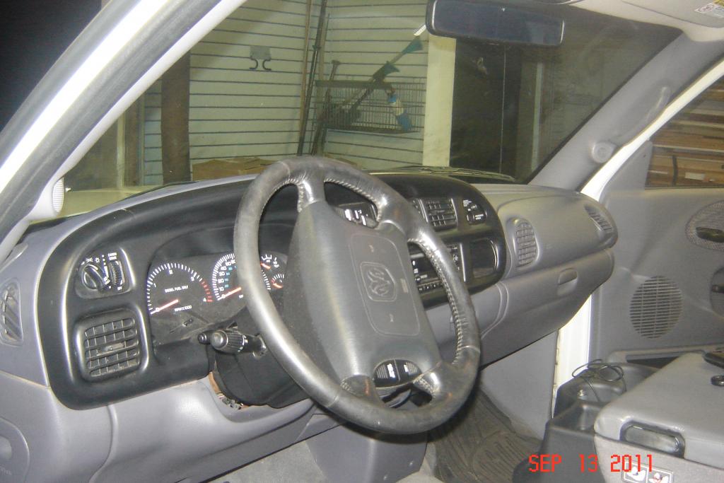

Well I finally got a chance to put my new dash in this evening.
Took me about 3 hours to put it in start to finish. I had a little bit of trouble getting the air ducts out an then I realized there were 3 more screws holding it in. (Not just the one at the V that zthatzmanz28 mentioned in his post) Once I got it out reassembly went fairly quickly. I also disconnected the airbag plug and set it aside. At first I was going to leave it hanging but I didn't like the pressure it was putting on the wires.
I forgot to disconnect the shift linkage and it stretched and came out of alignment when I dropped the steering wheel. I was able to reconnect it and with a little adjusting I have it lined up correctly again. Here are some pictures of the install.
All in all it was not too bad a job and I am really pleased with the new dash!

I also wanted to add that I didn't have to touch the vin plate. It is attached to the area below the dash support and the new dash does not interfere with it at all.
