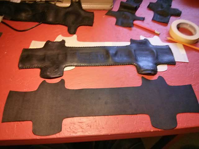

A lot of us have discovered the factory leather steering wheel covers don't last forever. Mine was making my hands black. Not good.
I do a little leatherworking and have some black leather so I decided to make a replacement cover. Not an overlay but a 100% replacement. Nothing real complicated but it took a lot of work to get it right since I've never done a wheel before. Had to redo the stitching a couple times. Turned out great in the end. I used red stitching for my red truck. Plus, my other turbocharged vehicle is a VW GTI with red stitching and I like it.
Here's a rundown of the project..
Removed steering wheel. Removed back cover and switches.
Cut stitching and removed old cover.

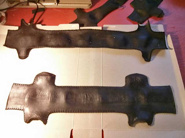

It's made from two pieces so I cut them apart, laid flat, and made templates from a cereal box. Corn Flakes, to be exact.
Used templates to cut out new leather.

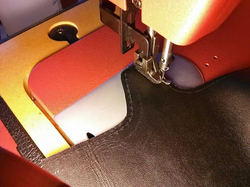

Removed thread from sewing machine and used it to pre-punch the holes for hand stitching.
Sewed the two pieces together to form the new cover.

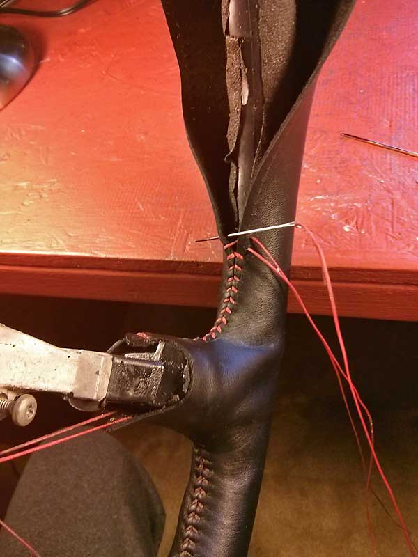

Hand stitched it with two needles and a baseball stitch.
Used a heat gun to shrink it around the spokes for a "not quite perfect but pretty darn good" fit.
It should last another 16 years before I have to do it again, lol.
