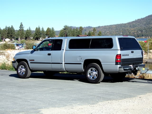

3rd. gen. 265/70 Mich. on my 2wd 1998.5 2nd. gen.
3rd gen rim is wider and seems to be off-set to the inside
Outside edge of rim seems stick out the same as the original 6.5 wide rims but I may be wrong. No noticeable rubbing
Update: 2nd. gen 6.5 wide rim- 4.5" off-set to the inside.
3rd gen. 8" rim- 6 1/4" to the inside
