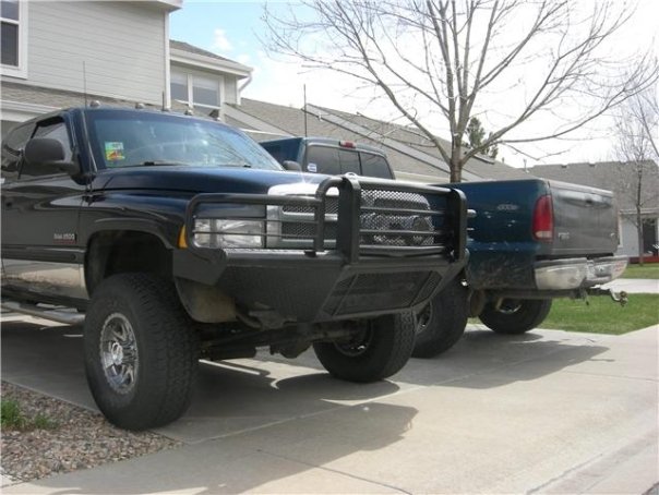

Not to hijack thread. Looks great, very similar to mine...and yes I did cut off the fender wells
