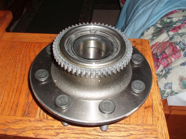

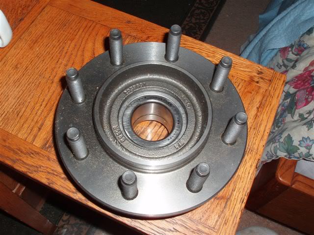

2wd bearings on a 2001 and 2002 are the same and NOT serviceable...pics of bearing and hub assy for 2001 and 2002 2500 and 3500 2wd
Size:  62.1 KB end of story!!!!
end of story!!!!
I think the '00 also went to the sealed bearings.
Is it not a castle nut with a cotter pin on these like every other vehicle out there? Is there enough thread on the spindle to double nut it?

castle nut is on the 4wd ..... a self locking nut on 2wd....i carry an extra
