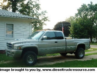

if you can get the sport bumper with the mounting brackets, it will bolt right up to your frame, some have issues with the intercooler lines, but I didnt. I put a 2000 sport bumper and grill on mine a couple of years ago, but have since removed and sold and went with a REAL bumper!lol, you will want the 99+ sport grill though to, to finish the look, it has a dip in the lower section that runs with the bumper.
