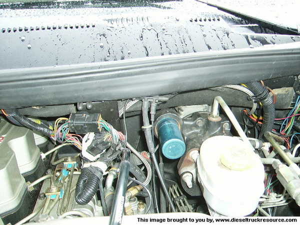

Check for a loose/disconnected vacuum line near the brake booster.
Did you just change the fuel filter?

Originally Posted by tbrunson
I will check more vaccuum lines when I get home, saw this online.
http://www.justanswer.com/questions/...am-2500-deisel
except my CC seems to work fine.
If thats the case and the other vacuum lines in the picture that shovelhead posted are OK then check the small black plastic vacuum line that goes through the firewall at the AC fittings, thats the one that runs all the dash vent doors but not the blend door. It might be that actual actuator though as you say all other modes work OK?
