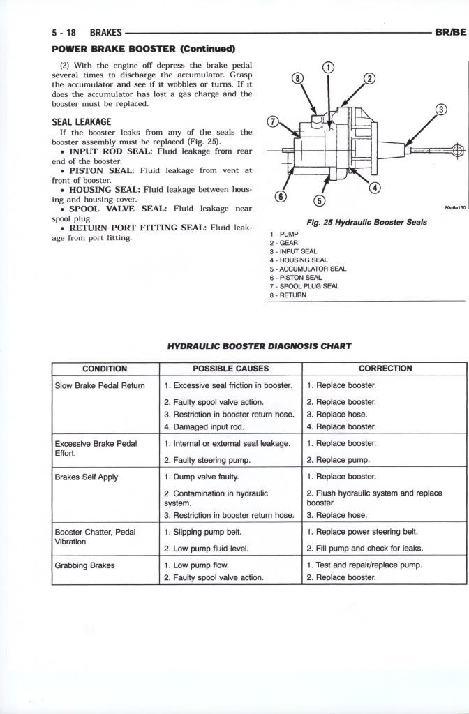

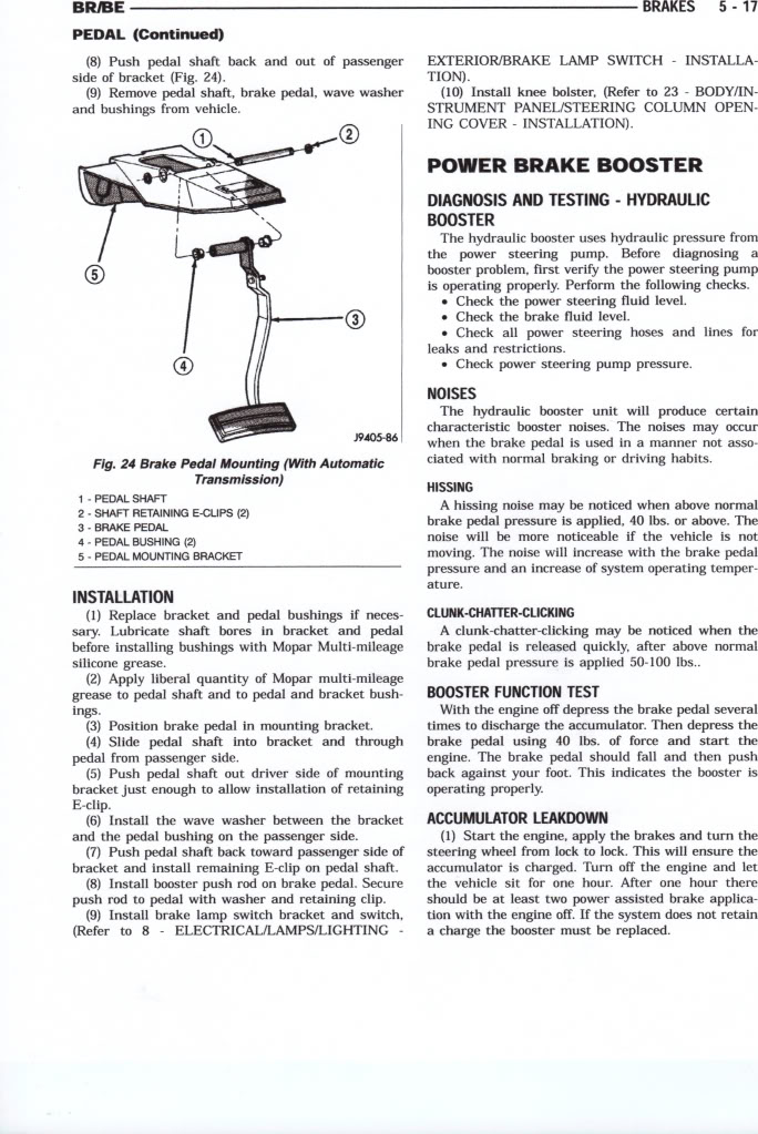

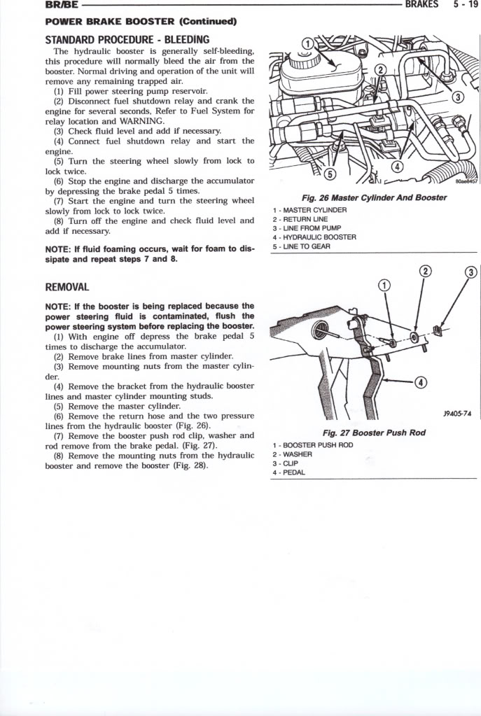

have you flushed the powersteering fluid recently?
old fluid can cause issues with the hydroboost.

Thanks for the info! Would've never thought of that. I don't think my '96 has hydroboost tho. Still vacuum operated.
