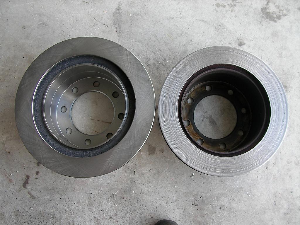

Well, I finally did it. It seems that my driver's side rear pads like to come off their backing and grind my rotor down to nothing. This has happened twice in my 10 years of having this truck. I can live with that but I decided to try the big brake upgrade in the rear as the one in the front has been nothing short of miraculous. I bought all the parts locally since I wanted to be able to return them if they didn't fit, but would probably buy the rotors from RockAuto.com for $75 vice my $93 ones from AutoZone.
The install was extremely painless and only took about an hour per side. Just remove the old stuff and put the new stuff on. The '03 rotor is 1" bigger in diameter so I should get some really good panic stops from the whole setup....
Here's a rundown of my parts and costs (all from Autozone):
2 rotors: Duralast 53011 $93 each (2 year warranty)
2 brackets: Duralast 14-1224 $26 each (lifetime warranty)
2 calipers: Duralast C717, C716 $55.99 each (lifetime warranty)
Duralast lifetime pads: MKD702A $21.99 (lifetime warranty)
2 big bottles of brake fluid: $5 each
TOTAL: $372 plus $100 core charges for calipers (refundable)

I'm running 315/70R17s. Well, I didn't do anything except change the rotor in the rear and the parking brake works fine now. I crosschecked the parking brake drum shoe size on RockAuto.com and they were the same. From that I figured that the drum in hat brake sizes were the same. While the brakes were off I adjusted the parking brakes via the star wheel and am pretty happy with the results. The ONLY thing different is that the rear drums cost about $40 more apiece than the OEM ones do. For my money, that is not a problem and I love the new, larger brake drums and calipers....
