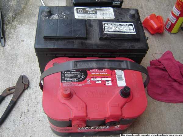

Heres a size comparison of an Optima vs. a normal lead acid (this is a factory Mopar batt). The Optima is smaller but puts out more power than the lead acid.
Battery specs :
---------------------------------- Lead acid ------- Optima
Cranking Amps (CA) @ 32°F ---------900 Amps -------1000 Amps
Cold Cranking Amps (CCA) @ 0°F ----750 Amps --------800 Amps
Reserve Capacity (RC) --------------Unknown --------100 Minutes
Hope this helps.
