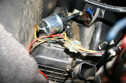

This is a problem on these trucks. There is a TSB on it. The vacuum pump leaks oil into the lines and causes the rubber diaphram in the actuators to deteriorate.
Happened to my 96. There an actuator just above the accelerator pedal, slightly to the right, mounted vertically on the heater box. It must be replaced.
The TSB says only 95 and 96, but you know how that goes.
http://dodgeram.info/tsb/1996/24-16-96.htm
http://dodgeram.info/tsb/recalls/720.htm
Pic of the actuator, looking up from the driver's side, above the go pedal:

Thanks very much! I see it has a yellow tube - the branch I think is my problem. I'll check mine out in a few. Craig

Yippeeee - that's it! That's the leak I was looking for and it has oil in it. I'm going to get a new one this AM. craig
