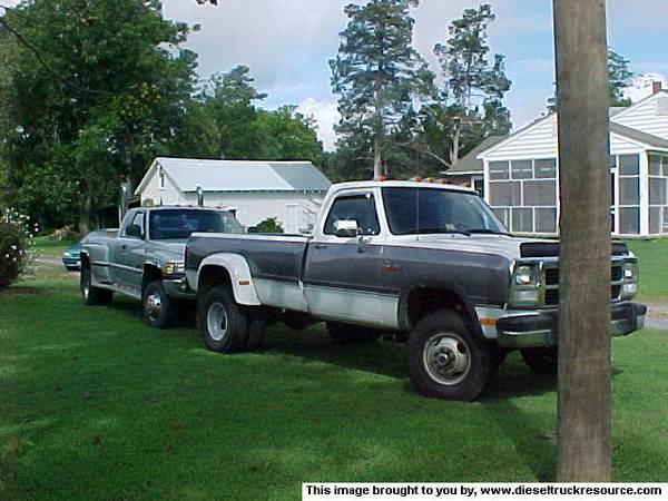

Originally Posted by sootnsmoke
Anyone owned both a 1st and 2nd gen?
You mean like this? Also had an 89 and a 95 at the same time.
