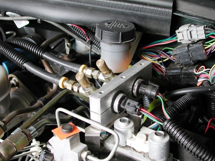

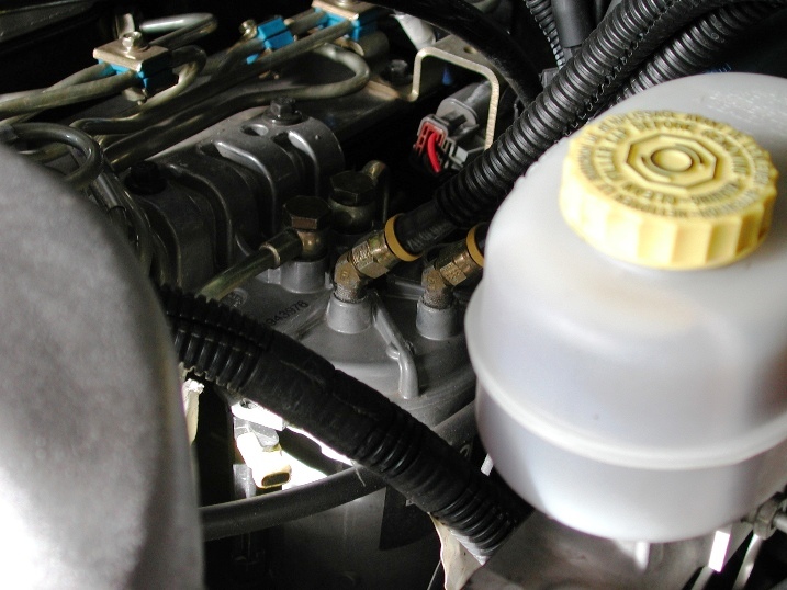

Is the pressure transducer remotely mounted?
If its mounted someplace where the engine vibrations can hammer it, there may be problems. I remotely mounted mine, when I installed them in AUG of 2000.
Nice Job, mines just simply screwed into the filter housing...
