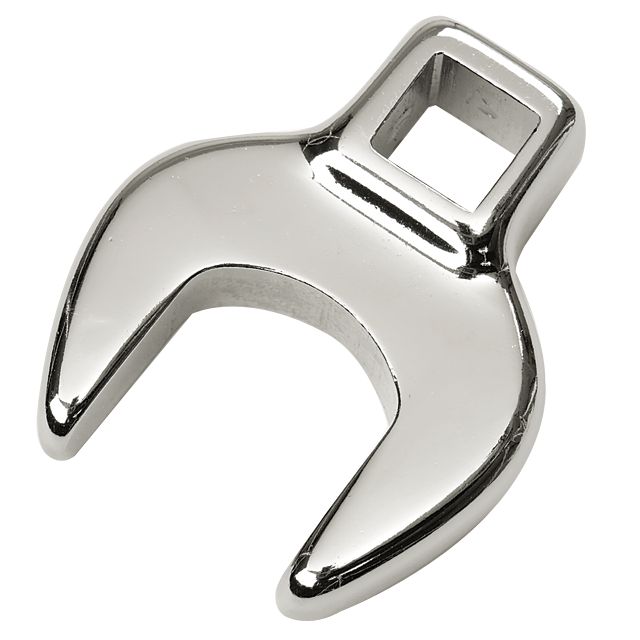

And a 3/4" crowfoot socket will make getting that number 6 injector line loosened up a lot easier.
don't ask me how I know this
Crows Foot socket image
