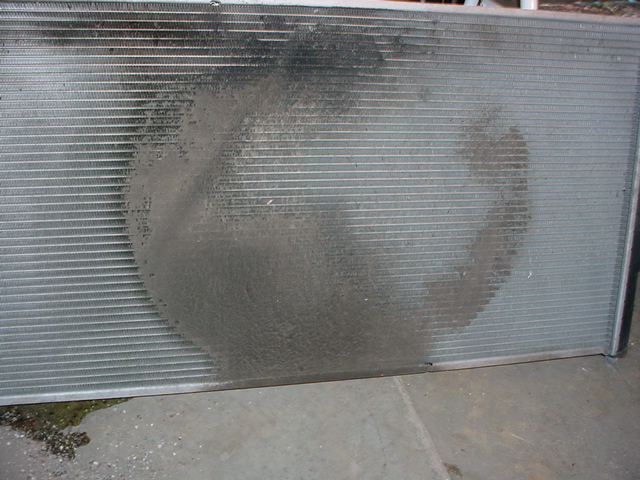

Clean your radiator. This photo is the side that faces the A\C condenser .

2002 5.9 That picture looks familar. I saw a picture like that in the early spring. That was all it took for me to extend that hose and pull the rad to give it a once over and have it flushed for the summer months. Glad to say i haven't had any problems

Hey chainzaw, yea, I have posted it a couple of times. I was in no hurry to pull my radiator and clean it since at first it didn't appear to be dirty. What a suprise when I got it out. Now my temp gauge stays right at 190 even in the summer heat pulling a 6,000 lb trailer through the ozark mountains with the A/C on. NICE !!!!

Looks like mine, too. My wife and I pulled the rad and cleaned it with simple green and blasted it out real good. We were having overheating probs, also, while towing.. next trip is this weekend. We'll keep our fingers crossed.
