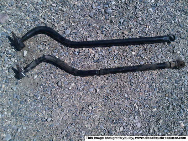

Here are the two trac bars I had to work with. Luckily neither are stock.
I ended up installing the one on the top with the adjustable ball joint. Both are pretty beefy.
Does anyone know what the one with the adjustable length is? I want to replace the ball joint so I have one ready to go for when things wear on the one that I put in there.

I would guess the one on the bottom is for a lifted truck from the angle and adjustment.
