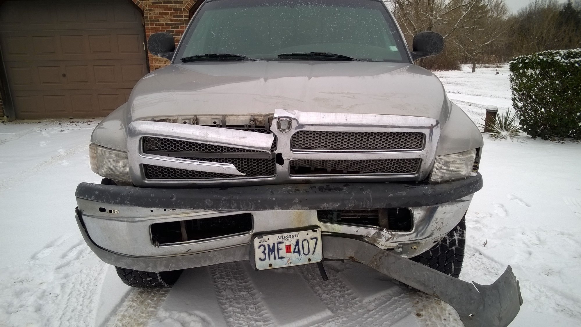

FYI. I'm repairing a truck that was crashed into by an un-insured driver...... Figured since I have the front of the truck removed, good time to do some maintenance,
