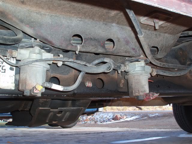

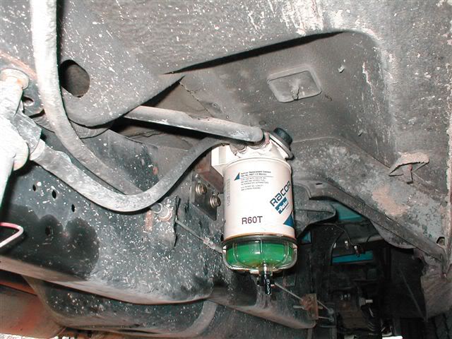

Originally Posted by 77machomopar
I was thinking about that since the block i have is a 12valve and has the cam in already. Whats the psi that is recommended to the IP? thanks
the manual says 15 psi but some including me have run 21 with no problems.... i'm currently running around 12 with my campaign pump on the frame and the racor pre pump filter
Size:  68.2 KBName:  P1010161-1.jpg
