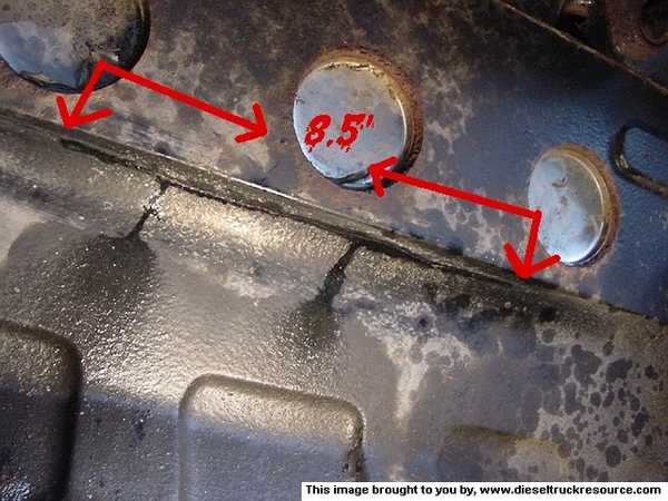

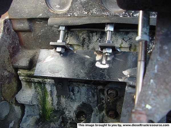

I tried Loc-N-Stitch and it still seeped,,I came up with this repair and it worked great! Did not leak a drop in 10000 miles, Of course it was on a truck with a standard trans,Dont know what yours is, Then I got a Heck of a deal on an engine with 8525 miles on it and could not pass that up.. Maybe this will help you come up with something, Cost me about 10 bucks and some welding, My crack was 8.5 inches long
Dont know if this helps at all..

Is your first picture of the brace that you're supposed to attach after the lock-n-stitch procedure?

I believe it a picture of a brace he made to hold the rubber seal so it would not leak.

I should have skipped the Loc & Stitch, The bracket worked awesome,The bracket has a 1/4 inch steel plate welded to the heads of the 1/2 inch bolts so you can adjust pressure against the block and a heater hose split in half to create the seal,, When I get home from work I can take some photos of the bracket,,I still have it hanging on my garage wall..

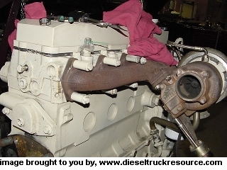

I installed a 2001 #55 or #56 Block in my 1998.5 the 2001 had the cam and crank sensor, It was actually a ISB 185 out of a airport shuttle bus that caught on fire(the front of the bus) and only had 8525 miles on it,Only bad thing was I had to drive to Ohio from Connecticut to get it. I put my VP injector pump and my ISB 235 injectors in it, Been running great ever since it now just turned 100000 miles, I have a 2001 CTD in my driveway under cover and will be selling it off this year,But selling it locally cause I don't want to get involved in the freight thing, I sold my cracked #53 engine minus turbo injector pump and injectors for $500.00 and the guy who bought it came from Wisconsin to pick it up.
