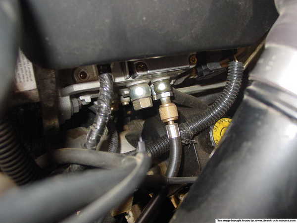

I found this picture. Look for a black cap on the side of your vp44, it's the cover for the schrader valve.

http://www.genosgarage.com/prodinfo....mber=VULCAN-FH
Here is an example of a fuel pressure line that will hook up to a schrader valve.

I just want the fuel pressure gauge. Is that a special fitting to screws into the VP44?
Don't forget to remove the valve from inside the {schrader valve} before hooking up your FP line to your gage , you can remove it with the same tool you use on your tire's.

Review the stuff availible from Geno' garage. They have all the miscellaneous stuff that can make your life easier for a fuel pressure gauge addition. If anything, it will give you some ideas.
I eventually went with a 30 psi Westach (electric) gauge, and tapped a transducer in with a hose like the photo above. The schrader valve is a bleed port at the fuel inlet.
